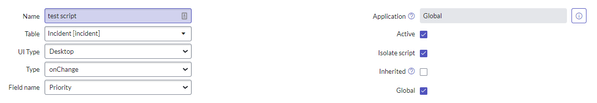

I have tried to write a very simple client script and script include which will simply show a message when the priority value changes on an incident record. This is just for testing purposes.
Could anyone point out what I have got wrong here as the alert always provides an answer of null and the log in the script include is not seen.

Ankur Bawiskar
@Alex319
this will fix it
1) your script include is marked client callable but the syntax it has is for server side i.e. it has initialize function
2) update as this -> remove initialize()
var IncidentScriptInclude = Class.create();
IncidentScriptInclude.prototype = Object.extendsObject(AbstractAjaxProcessor, {
    priorityUpdated: function() {
        gs.info('Priority field updated on incident record');
        return "success";
    type: 'IncidentScriptInclude'
