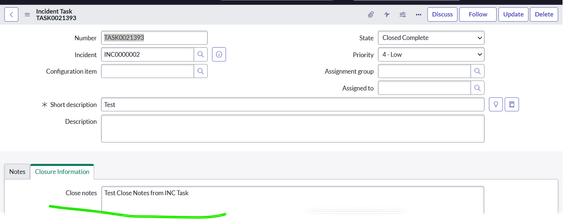

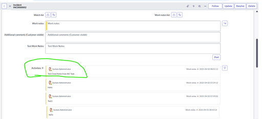

Hi @_Gaurav ,
i tried replicating the same but it did not work , below are my config and test results :
test results :

Hi @tushar_ghadage ,
Looks like you are updating the work notes of the incident task
you are suppose to update the close notes right?
what do you want to copy? incidents are close notes or work notes from incident task to incident
if it is close notes you can have follow below
if it is work notes follow below
