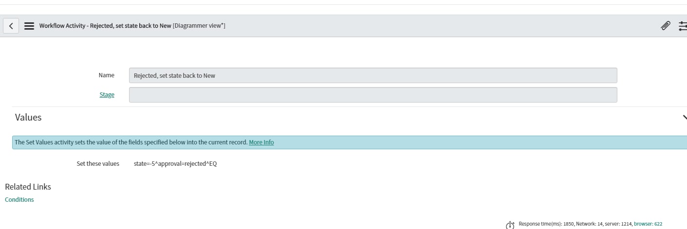

We have an approval step in our standard change workflow. On rejection we have a set values activity to set state to new and approval to rejected, this then connects to a rollback activity which links back to an earlier activity:
The set values activity is set as:
Hope this helps
Sam
