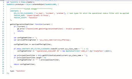

We have configuration item as a field on incident, problem, and change. The choice list is filtered to only include CIs from principal classes. We are now capturing configuration item on sc_task records and the choice list is showing all CIs. I've tried adding a dictionary override for the sc_task table, using the reference qualifier override. Looking at incident override, it uses TaskUtils script include which is an extension of TaskUtilsSNF. The OPS_FILTER_CLASSNAMES value includes only incident and problem tables as the task types used in the filter. My thought was that I needed to add sc_task to the task types. I first tried creating a new script using the same script content but with the addition of the sc_task table. I also tried setting the values in TaskUtils script to override TaskUtilsSNF. Neither way works, I still see all of our configuration item records in the choice list when selecting from a service catalog task record.

Here is my override script include in TaskUtils:

Hi Rita,
Open the TaskUtilsSNC script include from TaskUtils and copy the function from getConfigurationItemFilter() and override this function in TaskUtils.
This will resolve the issue.

05-30-2025 02:02 PM
Thanks for the quick response. I copied the function from TaskUtilsSNC and pasted in the TaskUtils script include. Here is the content now:
I gave this a try, it still does not filter correctly. Since this is an override to TaskUtilsSNC I'm not sure why copying the function intact from the original script would do anything different. Let me know if I've missed something.
05-30-2025 02:12 PM
Hi Rita,
Do not use the same function name as it might impact in other places where it is being used.
So create your own function with data you need to be passed and also replace the function name in your dictionary override.
