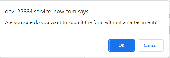

Hi Everyone,
I am working on a Client script to display a message(Are you sure do you want to submit the form without an attachment?) when a File Attachment field is empty. but it is not working for the Client script I have written.
Please take a look at the following code and correct me where I am going Wrong
function onSubmit()
var attach = g_form.getValue('u_test');
if (attach == ' ')
var uInput = confirm("Are you sure do you want to submit the form without an attachment?");
if (uInput == true)
return true;
else
return false;

But the client want it to be an "File Attachment " field on a Scoped Application. And they don't want it to be mandatory field. But a Message should pop up whenever an attachment is not attached to that field.

You can try this script
function onSubmit() {
if(!g_form.getValue('u_test')){
var response = confirm("do you want to proceed without an attachment?");
if(!response)
return false;
