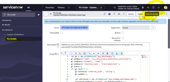

Fix script : It is server side script similar to business rule to update records in bulk manner which you can run on demand.
E.g., If you want to update the state of incident to closed which are older that 6 months like wise...
another example with screenshot :
