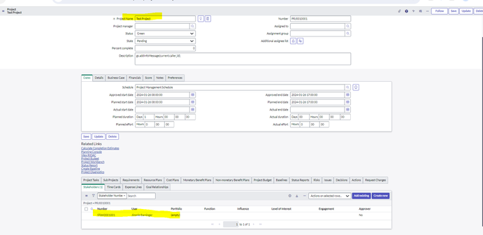

Hi Everyone,
I am trying to display the value on stakeholders table that is currently related list into Project.
Which i want to display the value using client script on this below field.
Can you check this below code ?
function onLoad() {
var PO = new GlideRecord('pm_m2m_project_stakeholder');
PO.addQuery('project');
PO.addQuery('expectationINproject_owner');
PO.query();
if (PO.next()){
g_form.setDisplay('u_project_owner' , PO.stakeholder.user.name.getDisplayValue() );

01-25-2024 11:29 PM
Hello @Jeck Manalo
If my understanding is correct then ,
1. There is custom 'u_project_owner' field on 'pm_project' table (what is the type of this custom field ..??)
2. In related list of there is tab for stakeholders (pm_m2m_project_stakeholder)
like below --
So you need to populate name of stakeholders related to Project to be displayed on 'u_product_owner' field which is present on 'pm_project' form...??
01-25-2024 11:34 PM
yes, you are correct its a custom field created by me.
all i need is to get the record on stakeholders that function is Project Owner.
type is "reference" for u_product_owner.
01-25-2024 11:36 PM
So you need to populate name of stakeholders related to Project to be displayed on 'u_product_owner' field which is present on 'pm_project' form...?? - yes correct, there is a different view that will show the 'u_project_owner'.
