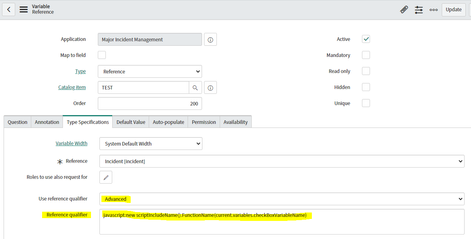

PPPanchal
Hello @Asmita ,
To achieve this, you need to add an advanced reference qualifier to the reference variable.
Please refer below screenshot:
And through script include you need to return the records according to your requirement.

PPPanchal
Hello @Asmita ,
