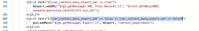

For the form view, it is driven from UI Macro
Before :
Navigate to :
----------.service-now.com/sys_ui_macro.do?sys_id=2ff1c56ca9fe3dba014340c4697b5088&sysparm_view=&sysparm_domain=null&sysparm_domain_scope=null
comment down 108 line.

One more thing to add here, it is also removing 'View' option. So, instead of commenting, change the condition on 107 line, from true to false.

Hi @Poorva Bhawsar ,
You can add the condition on the UI Macro,
here I have added the Incident table. So, apart from Incident table it will be available for every table.
Replace it for you custom table.
