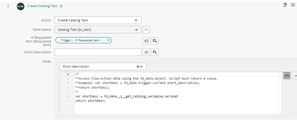

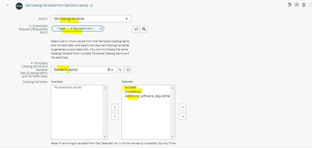

you can use get catalog variable action to get all variable details and then use this action variables in the create catalog task script it will look something like this
in the above screenshot i am passing 3 variables of standard laptop SR and now i will use acrobat variable in create catalog task action like this
so in your case u need to first get the catalog variable and then update your script something like this
