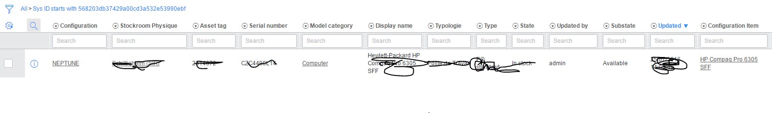

and filtring on previous sys_id in the Asset list works fine :
