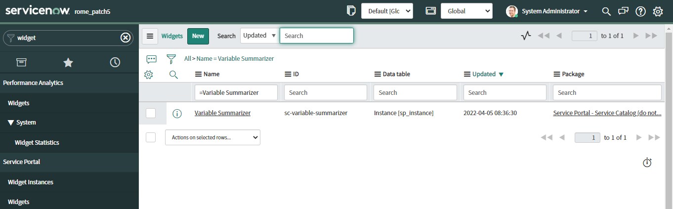

Hi! In our case, we had to clone an OOTB widget: Variable Summarizer
PART 1: CLONE THE WIDGET
After you clone the widget, update Body HTML template:
1. Look for these lines:
<label class="m-t-xs m-b-none text-muted"><b>{{::variable.label}}</b></label>
<div ng-if="!variable.multi_row">
2. Change them into:
<label ng-if="!variable.multi_row && variable.display_value != 'false'"
<div ng-if="!variable.multi_row && variable.display_value != 'false'">
3. Look for this line:
<div ng-if="variable.multi_row">
4. Add this code above the div in STEP3:
<label ng-if="variable.multi_row"
5. SAVE.
PART 2: UPDATE CONFIGURATION
Second half of the process is to update the widget used to render the variables in the portal.
1. Navigate to Standard Ticket > Standard Ticket configuration
2. Open the record for table: sc_req_item
3. In the Tab Configurations related list, open the record: Additional Details
4. In the Type field, change the value into: Custom
5. After STEP4, the field Widget will be displayed.
6. In Widget field, select the name of the widget cloned in PART1.
7. UPDATE/SAVE.
That's it! It should now hide the unchecked variables in the service portal.
For PART2, you can also refer to the attached file 🙂
5. SAVE.
7. UPDATE/SAVE.
Please mark my answer as correct if it helped you solve this issue.
You can also hit like/helpful if it did help you in any way. Thank you!
I also tried this in my PDI my question here is it will hide all variables? or only for particular variables?BCZ,when i submit the request it hides all the variables.
It will hide all the variables. Hence, need to add the ID to the widget, then it will hide only variables with false value in the portal.
hope this answers your question.
