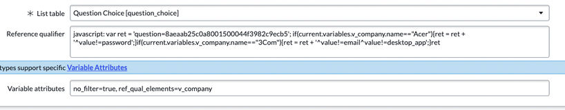

Hi Abbie!
I would be happy to help you with this. Like most things in ServiceNow, there's more than one way to do this. Here's potentially the easiest way, but if it gets too complicated we can put this in a Script Include that's called by the reference qualifier, or use an onChange Catalog Client Script to alter the filter on the List Collector. All you need to do is make your Reference qualifier and Variable attributes on the List Collector variable look more like this:
where v_company is the name of the Brand reference variable, and the rest you replace with your values. Here's the text of the qualifier following javascript :
var ret = 'question=8aeaab25c0a8001500044f3982c9ecb5'; if(current.variables.v_company.name=="Acer"){ret = ret + '^value!=password';}if(current.variables.v_company.name=="3Com"){ret = ret + '^value!=email^value!=desktop_app';}ret
and the Variable attributes, which ensures the List Collector variable will be updated when the value of the Brand variable changes:
no_filter=true, ref_qual_elements=v_company
Have fun!
