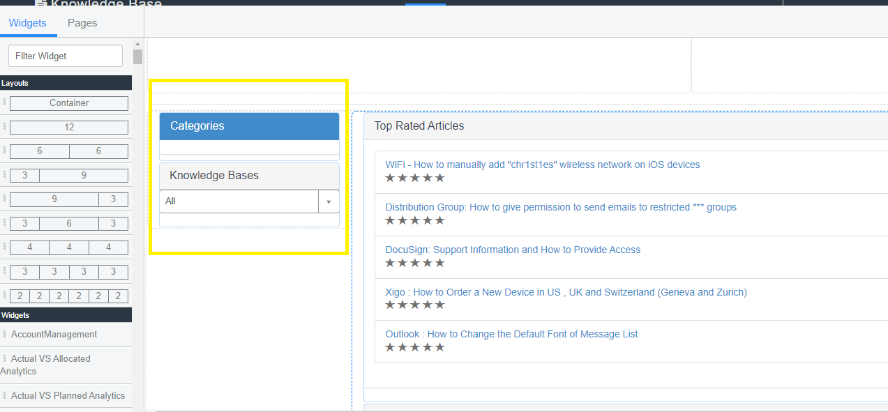

kb_home_page is a reference field where we can select the kb_view2.
tThis is the page designer kb_view2 and  the widget KB Knowledge Bases.
