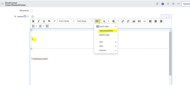

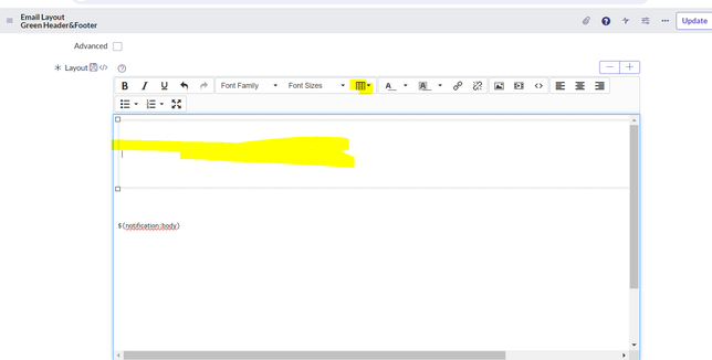

Step 1 : Create a table with single row in Layout field
Step 2 : Select the create row in layout and click on table icon (dropdown) and select Table properties

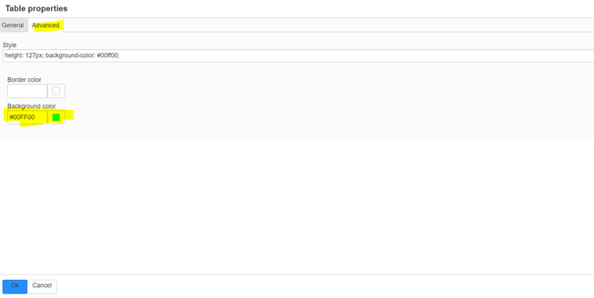

Step 3 : on Table properties select Advanced Tab & Put #00FF00 in Background color & click OK
You can follow the same step for footer as well

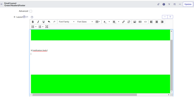

Put '${notification:body}' between header & footer
Layout should look like this :

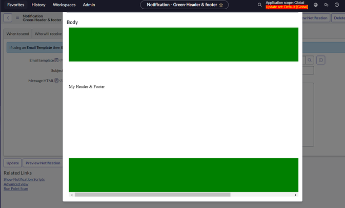

That's it use email layout in Email template and email template in Notification...!!!
Final Result :
This is my Notification with template containing email layout
Previewed Notification :
