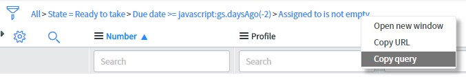

Replace the encoded query with this:
state=ready^due_dateRELATIVELE@dayofweek@ahead@2^userISNOTEMPTY
The easiest way to determine this query string is to build the right filter in a list view, right-click the breadcrumbs at the top, and select Copy query. (Ignore the actual text of the breadcrumb in this screenshot... it's just meant to demonstrate how to right-click and select Copy Query.)
