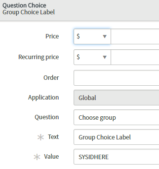

You will need to find those groups you want to fill from the Select Box in the Groups [sys_user_group] table. Once you find a group, right-click on the name from the list and select Copy sys_id:
Then from your Select Box, open the appropriate Question Choice record. When in that record paste what you just copied from above into the value field:
Repeat for all choices for that Select Box. Then, after you have your onChange Catalog client script built it will set your reference variable accordingly.
