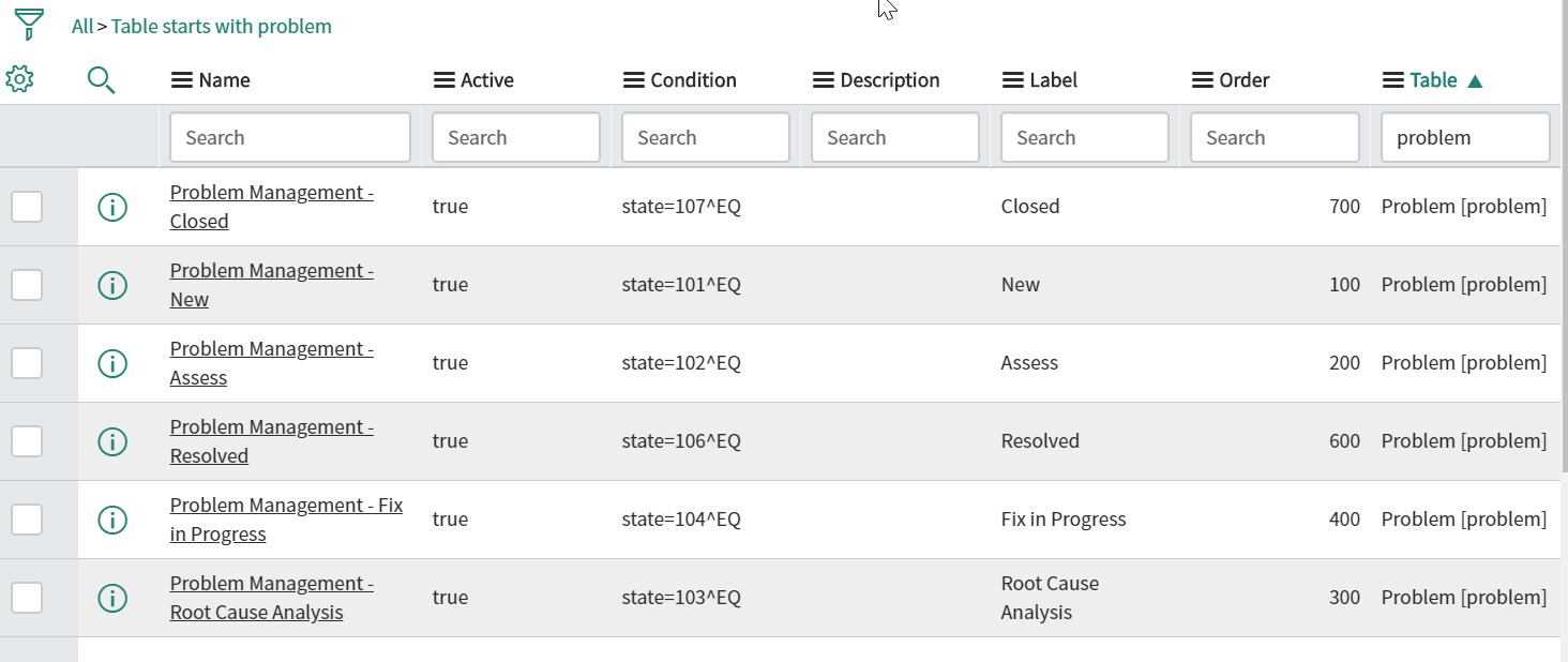

3. Navigate to process flow to configure the flow (Optional - may not be needed)
4. You can check to see if process flow record definitions are defined in your instance by searching using the table name.
5. You can create custom steps as part of the process flow if needed.
Name = Internal Name for referencing
Label = What is displayed on the formatter to the user
Order = Order in the chain this section is shown
Condition = condition on which the formatter will show as checked.
