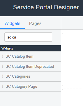

You can use the OOB widget called SC Catalog Item. You can the select the catalog item you wish to display.

can you please elaborate on this.
Like where should I use SC catalog item widget and select the catalog item that I wish to use.
Go to service portal configuration.
Select designer.
Select the portal page you want to edit.
Search for and select the icon link widget and place it on the page then you can set the type to catalog item and select the catalog item you want it to link to.
