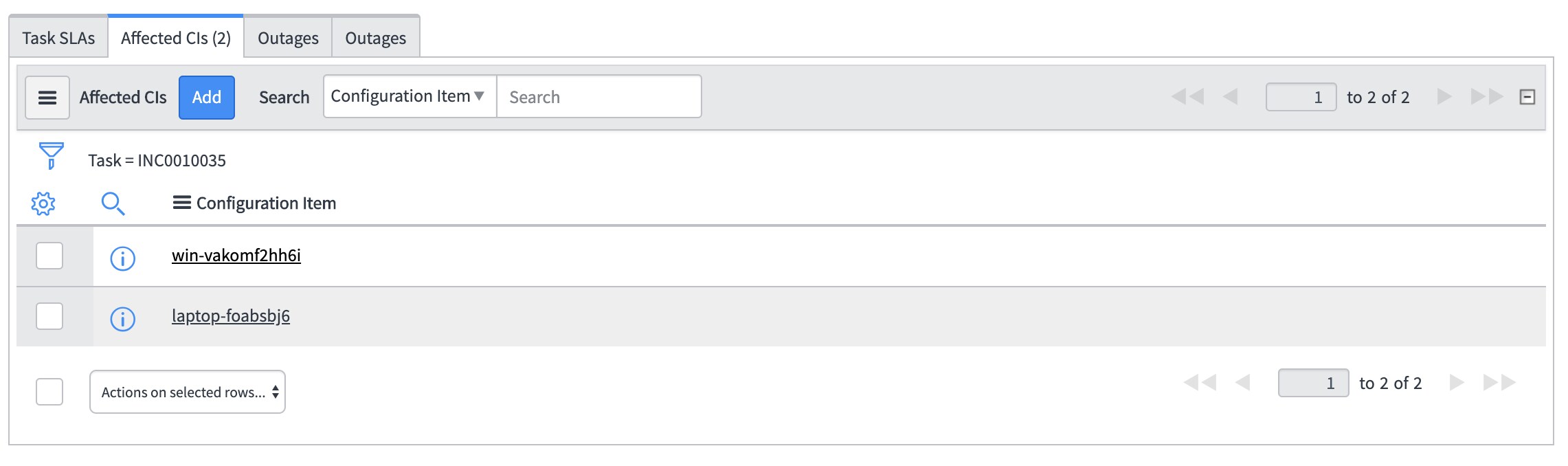

Here's the Change Related List -> Affected CIs
When I open two of the CIs, the Change Record is not there.
There are 2 different tables.

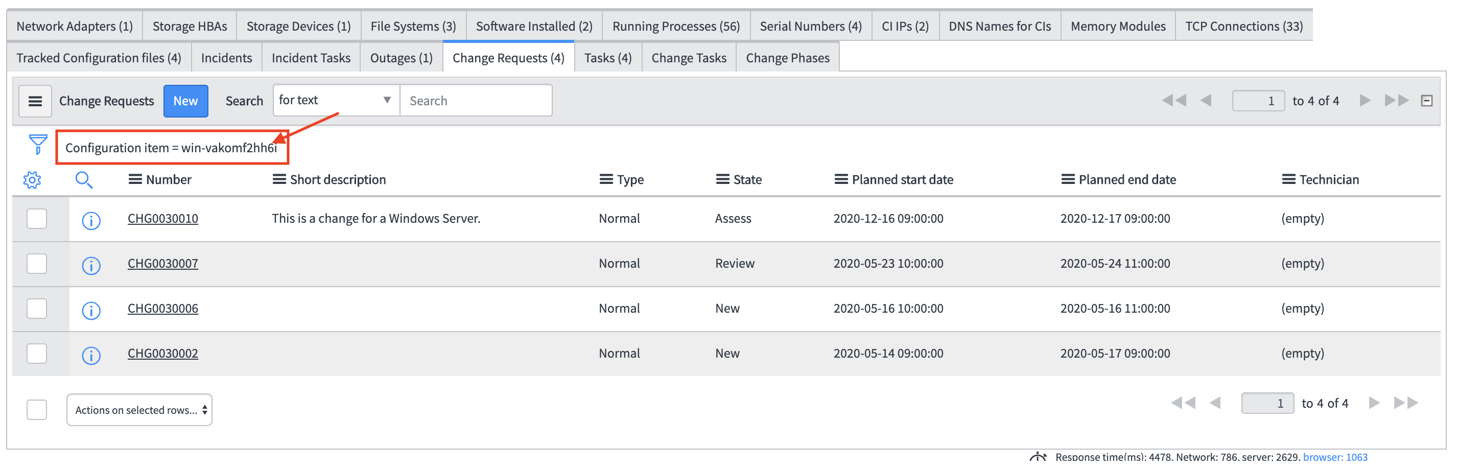

But how can I display this Change Request on the CI view? Here's the related list config for the CI -> Default View.
Change Request --> Configuration Item should display. Can you also try Change Reques --> Business service
Change Request --> Configuration Item: It filters the list by Configuration Item field.
Change Request --> Business service: It is not present in the available option.
