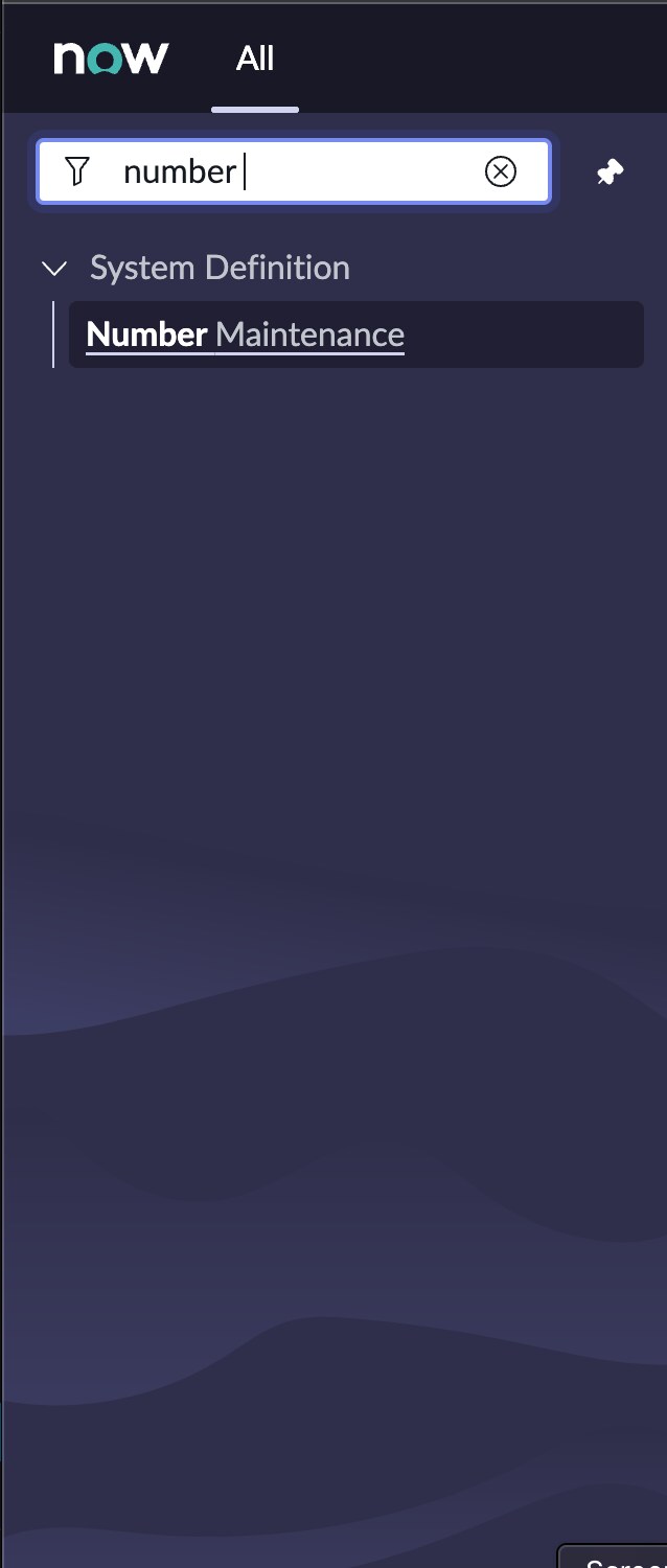

Go to Number mantainence table and find entry for your table and make changes, It will affect new records, it won't reflect in existing records. You have to run background script or fix script to change prefix of existing records. Please see below link

Also Number maintaince table link:
https://yourinstance/nav_to.do?uri=%2Fsys_number_list.do%3Fsysparm_userpref_module%3D10e86ef3c61122750035cf9c7f4d00dc%26sysparm_clear_stack%3Dtrue

Hello
for changing the prefix you can follow below steps
Go to number maintainance
Search for you table and update it
You would have to write a fix script to update the number for the existing records .It will only be applicable to new records like below
