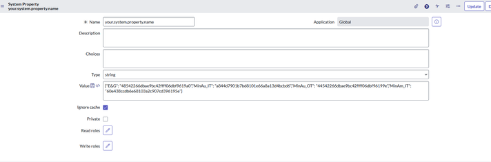

Subhashis Ratna
Hello @nikhitha24
As developers, optimizing code for maintainability is crucial. Storing SYS_IDs in a System property enhances flexibility, enabling non-technical users to manage server and assignment group configurations easily. This approach facilitates future adjustments without code changes, promoting adaptability to evolving business needs.
You can give a try to my updated script and check screenshot below and modify it further as per requirement.
var serverName = current.variables.select_server_name.getDisplayValue();
task.short_description = "ABAP | " + current.variables.what_type_of_restoration_do_you_need + " | " + serverName;
var selectAsset = current.variables.select_the_asset;
var assetToSysIdMap = JSON.parse('your.system.property.name');
for (var asset in assetToSysIdMap) {
    if (selectAsset == asset) {
        task.assignment_group = assetToSysIdMap[asset];
        break;
current.update();
System Property :
Mark Correct if this solves your issue and also mark Helpful if you find my response worthy based on the impact.
Warm Regards,
Subhashis r7
