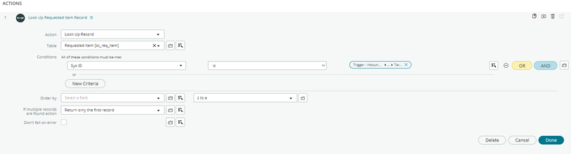

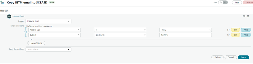

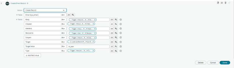

Created a flow designer that copies any email received activity that goes into RITM to SCTASK. But it is not working. The flow is not triggering at all. The flow works if/when we test it in the Flow Designer.
The scenario is when an external user replies to an RITM case we want the email received activity that goes into RITM to be copied into SCTASK.
Below is the flow design. Any idea why it's not triggering?

Please check your inbound emails to make sure it meets the criteria that you've specified in the trigger for this flow.

02-22-2023 07:18 PM
Trigger can't be tested by the "test" button.
Remove the subject condition and reply a test mail to have a test.
If it works , change the condition to subject starts with "RITM" may works (i guess the subject doesn't contain "Re:" ,).
02-23-2023 12:38 AM
Hi there,
Thanks for the reply. We've tried with no conditions at all, and the flow is still not triggering
