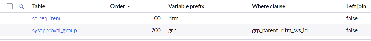

Hi Michelle,
It sound like a Database View will get you going in the right direction.
https://docs.servicenow.com/bundle/tokyo-platform-administration/page/use/reporting/concept/c_Databa...
You would join the sc_req_item and sysapproval_group tables on the RITM sys_id, and this will give you access to every field on both tables for your report - which will now use the database view name as the table.
Here's what your database view will look like:

Hi Michelle,
Hi
We do not have that view as it will be owned by out platform providers.
is a way of running a report that will give me this information and I can then just add it as a widget  ?
If not I will ask our providers to create a report for me.
