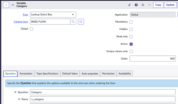

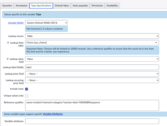

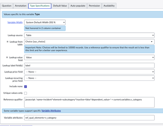

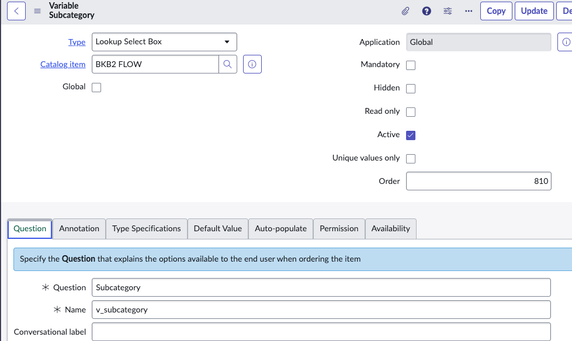

Here's an example of how I have 2 lookup select box variables - Category and Subcategory - to mimic the incident out of box choice lists.
The Reference qualifier and Variable attributes of v_subcategory show how the dependency works
If your lookup tables are not sys_choice you would just update the reference qualifiers in a way that makes for your scenario.
