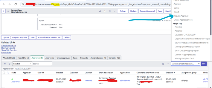

How to edit this UI action button "Request approval" on sc_task table, under Approvers tab?
I want to either edit it to write a script or, remove it? Please help. (Also, please ignore the other "Request Approval" button on the context menu. That is a custom button.)

I think, We can’t hide a UI Action from the list Choice (like on sc_task) using a condition
However, we can disable the functionality of that UI Action instead.
I handled this by creating a Script Include to check the table name and then used it in the UI Action’s condition.
Script Include:
Ui action:
Result:
sc_req_item table:
sc_task table:

That UI Action will be on Approval table(The table that is linked to that related list) and not sc_task table
Check UI Actions on Approval table which has 'List Choice' checkbox to true and modify accordingly.

Since, this List choice button is also being used on RITM table, I don't want to modify the script. But how can we restrict this button to not be visible on sc_task table? Please check.

Since, this button is being also used on RITM table, I don't want modify the script. But how can we restrict this button to not be visible on sc_task table? Please check.
