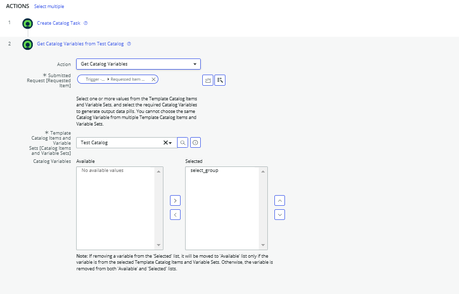

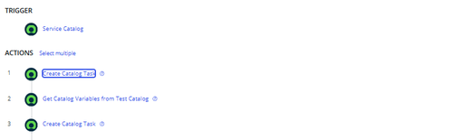

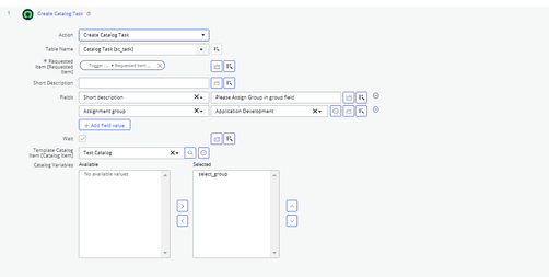

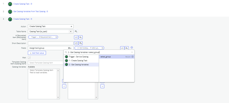

Hi @snbansode ,
Please have a look on below screenshots
My flow is like once request is generated then First task is generated.
Fulfiller of that task is selects a group on catalog variables. further,
Second task is created and assigned to the group which is selected by fulfiller of first task.
