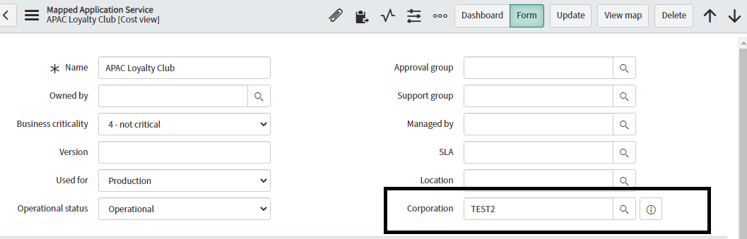

I request you , please help me on below issue.
 "cmdb_ci_service_discovered" table record has 'Corporation' field which referencing "u_corporation" table
Request : Corporation record has "Node" reference field which is referencing same table of record itself  .
Here Hierarchy:  CMDB ServiceDiscovered has "corporation"  field which referencing "Test 2" ----> Test 2 record of Node field Referencing "Test 3", Test 3 record of Node field Referencing "Test 4".......etc..
So now we need to check till which corporation record of Node field  is empty . so that record display need to Display in CMDB ServiceDiscovered.
