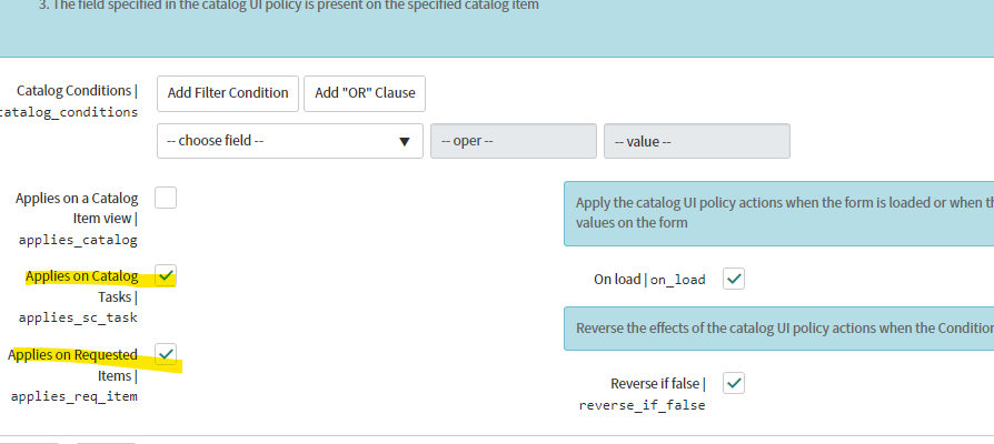

ersureshbe
The above screenshot shows UI Policies restricting to change the variable value in the form.
You can use the same logic to hide the unselected variables. Use UI Policy and disable other choice which are non selected.

can you give example how to write UI Policies
Please refer below steps. Create the UI Policy with below option
create the script using below option
I tested with 2 sample field. You use the same logic and implement in your instance
