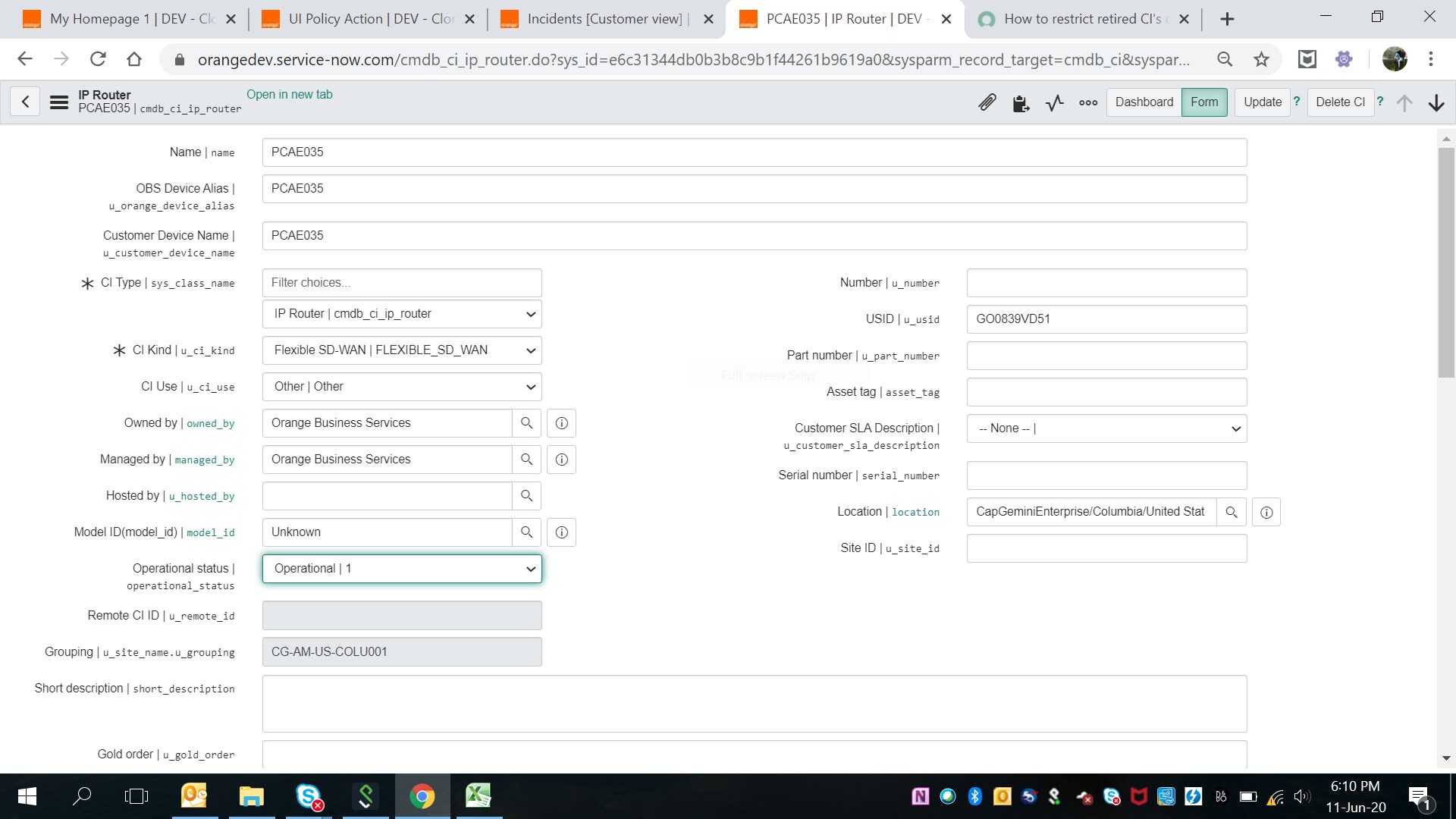

Below I have written it in short and simple way :-
CI's with Retired devices option from configuration item table/form should not be available on incident forms cmdb_ci field.
Image 1 : when CI is retired on cmdb form
Image 2 : then that CI should not be available on incident form - cmdb_ci field.
