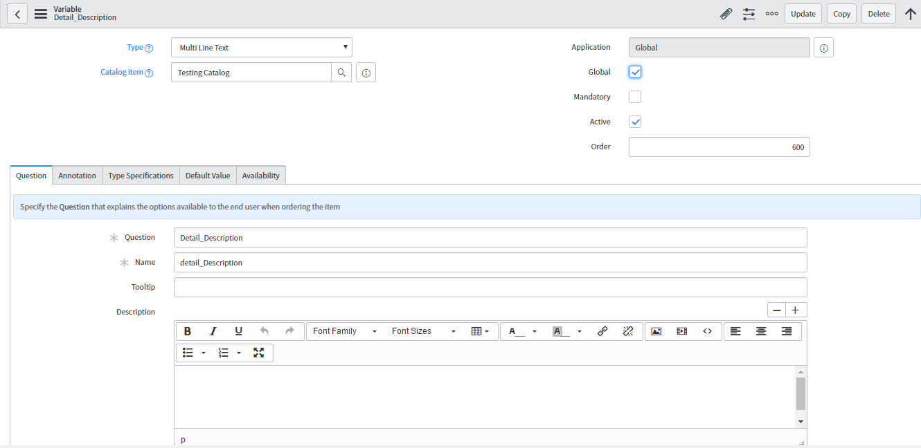

3) Once the field has been created and Choices has been defined in your desired Table then Navigate back to your catalog Item and create a new Variable called say Detailed Description(Don't Worry about this Variable, Once all the Configurations are done we are going to hide this Variable from all views)   with Type as Multi Line Text and default Value specified as per the below script:
Script:
javascript: (function getChoiceList() {
  var arr = [];
  var choices = new GlideRecord('sys_choice');
  choices.addQuery('name', 'u_acl_testing');                               //Replace your Table Name here in place of u_acl_testing
  choices.addQuery('element', 'u_city');                                               //Replace your backend Field Name here in place of u_city
  choices.addQuery('inactive', false);
  choices.orderBy('sequence');
  choices.query();
  while (choices.next()) {
      arr.push({
          label:String(choices.label),
          value:String(choices.value),
          hint:String(choices.hint)
  return JSON.stringify(arr);
So now once the above Detailed Description field is configured, if you check your Catalog Item form, it should have this Variable Detailed Description with the Choices and Hint Value present in that Variable in JSON Format as shown below:
