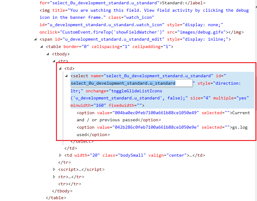

Unfortunately, when the glide list is populated (in my case:
document.getElementById('u_development_standard.u_standard_nonedit').innerHTML = 'Current and / or previous passed, gs.log used';
document.getElementById('u_development_standard.u_standard').value='004ba0ec0feb7100a661b88ce1050e49,042b286c0feb7100a661b88ce1050e9e';
This populates it, however when I click the magnifying glass to add / remove, there are no entries in the slush bucket.
Looks like there is more I need to populate but not sure how:
If you're starting off with an empty list and you want to add to it, you should also see a "_edit" which you're probably aware of since that is the element that contains your actual glide-list and you needed to change the display value to get it to show. Or at least that's what I get and had to do.
So inside of that you'll see the list is actually a simple select element that if not empty would contain option elements. If you want to add/remove to that then you need to do the same as before and capture it via DOM.
I believe the id for the select element would be something like this "select_0u_development_standard.u_standard".
So document.getElementById('select_0u_development_standard.u_standard') should do it. From there you'll need to create an element and stuff it with the desired data. Then append it to the select element. Something like this:
var selEl = document.getElementById('select_0u_development_standard.u_standard');
var optEl = document.createElement('option');
var txtNd = document.createTextNode([your display value if different from actual value]);
optEl.setAttribute('value', [your actual value. usually the sys_id]);
optEl.appendChild(txtNd);
selEl.appendChild(optEl);
All of those values should correlate to what you already have going on with the previous stuff. Of course you can optimize the code so that you can add multiple at a time. I'll leave that up to you though.
I forgot to mention about the clicking on the magnifying glass. Do an inspect element on the magnifying glass and check to see what is assigned to the "onclick" attribute. It should have something similar to this:
onclick="reflistOpen( 'u_development_standard.u_standard','u_standard','[?]','null', 'false', ''); mousePositionSave(event); event.stop();"
Take notice of the red question mark. That is where the table is referenced to bring in the records to choose from. It might be null in yours therefore making your slush bucket empty.
