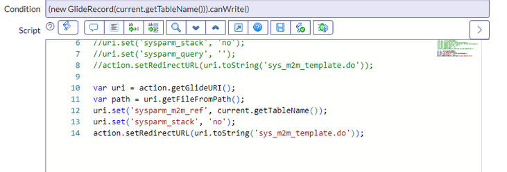

I 'm trying to figure out how to use the sys_m2m_template.do slush bucket. I see from some of the other 'Edit...' UI actions, that many use this:
var uri = action.getGlideURI();
var path = uri.getFileFromPath();
uri.set('sysparm_m2m_ref', current.getTableName());
uri.set('sysparm_stack', 'no');
action.setRedirectURL(uri.toString('sys_m2m_template.do'));(Not sure why the "var path" line is there since "path" is never used.) This didn't work for me at all until I set the "Action name" to "sysverb_edit_m2m". Now, it redirects to the template, but just sits there "Loading".

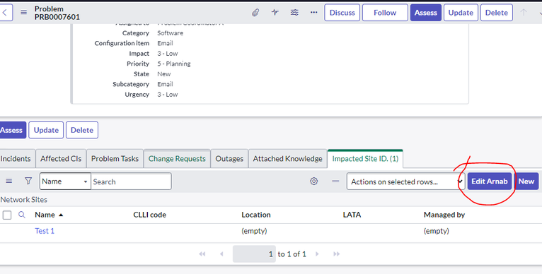

Setp -1
Step 2 ( Create a relationship in Problem table and add in my case use - cmdb_ci_ni_site table ) and on it add the UI action , UI action condition mentiond in step -1
Now once I cleck the edit button its showing loading state.

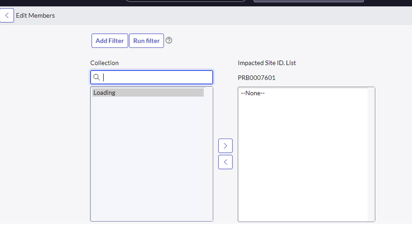

Step -3
Once clieck on the 'Edit Arnab' UI action its showing as loading like below and picking up data from cmdb_ci_ni_site table.
I want to bring the Test1 value in left pane so that I can select to right pane.
10-05-2023 08:57 AM
If you create a m2m table between two tables you generally will have the edit button available by default in the related list.
Please mark my answer as correct based on impact.
10-05-2023 08:57 AM
10-06-2023 02:05 AM
Yes you are correct.
