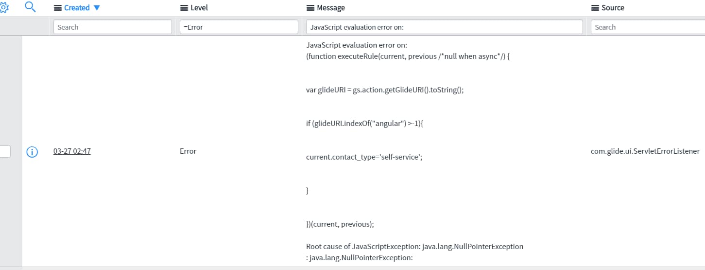

Getting bellow error in logs close to 300 daily. Please assist.
JavaScript evaluation error on:
var glideURI = gs.action.getGlideURI().toString();
if (glideURI.indexOf("angular") >-1){
current.contact_type='self-service';
})(current, previous);
Root cause of JavaScriptException: java.lang.NullPointerException
: java.lang.NullPointerException:

Hi Jay,
are you sure the logs are coming because of above script shared?

Hi Jay,
the below method works well in global and scope app as well; so I don't think any issue here
Is that a before BR which tries to set the contact_type as self_service if the url contains angular?
What are the log timings?
Can you add try catch block to check exception
try{
if(glideURI.indexOf('angular') > -1){
current.contact_type = 'self_service';
catch(ex){
gs.info('Exception is: ' + ex);

I have disabled the business rules since they are not required. Now I'm not getting the errors.
