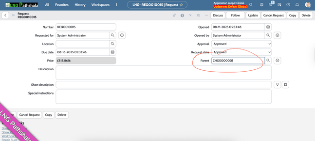

Dr Atul G- LNG
Hi @joshmorris
"You need to identify what is common between the REQ and the Change Request. If that common field has been filled, then the linked has been created.

Hi @joshmorris
