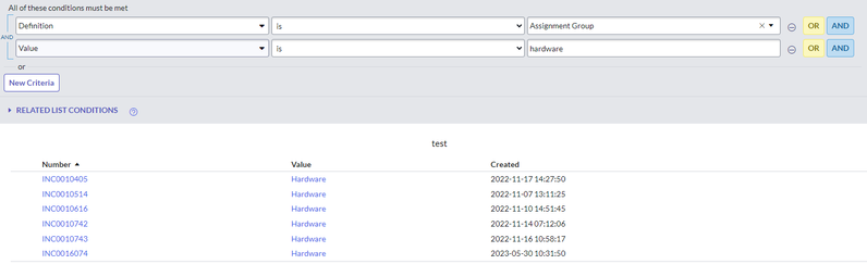

Hi @Deep_D ,
If you ensure you have the metric definition as below:
And afterwards create the reports as below on the incident_metric table:
As you can see from the sys_history, this match when incident was assigned to the chosen assignment group:
best regards
Anders
