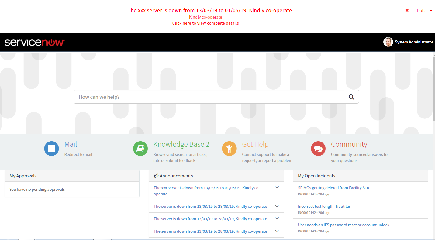

I am working on announcement in service portal, currently i am displaying the announcement with TYPE as Banner,widget.
I want to reduce the height or remove the padding of the banner.Rest of the portal is appearing something messy for the existing announcements.
Does anyone know where to reduce the components(CSS) of the banner in service portal.
Is it displaying at the top due to widget configuration or something other than that please let me know.

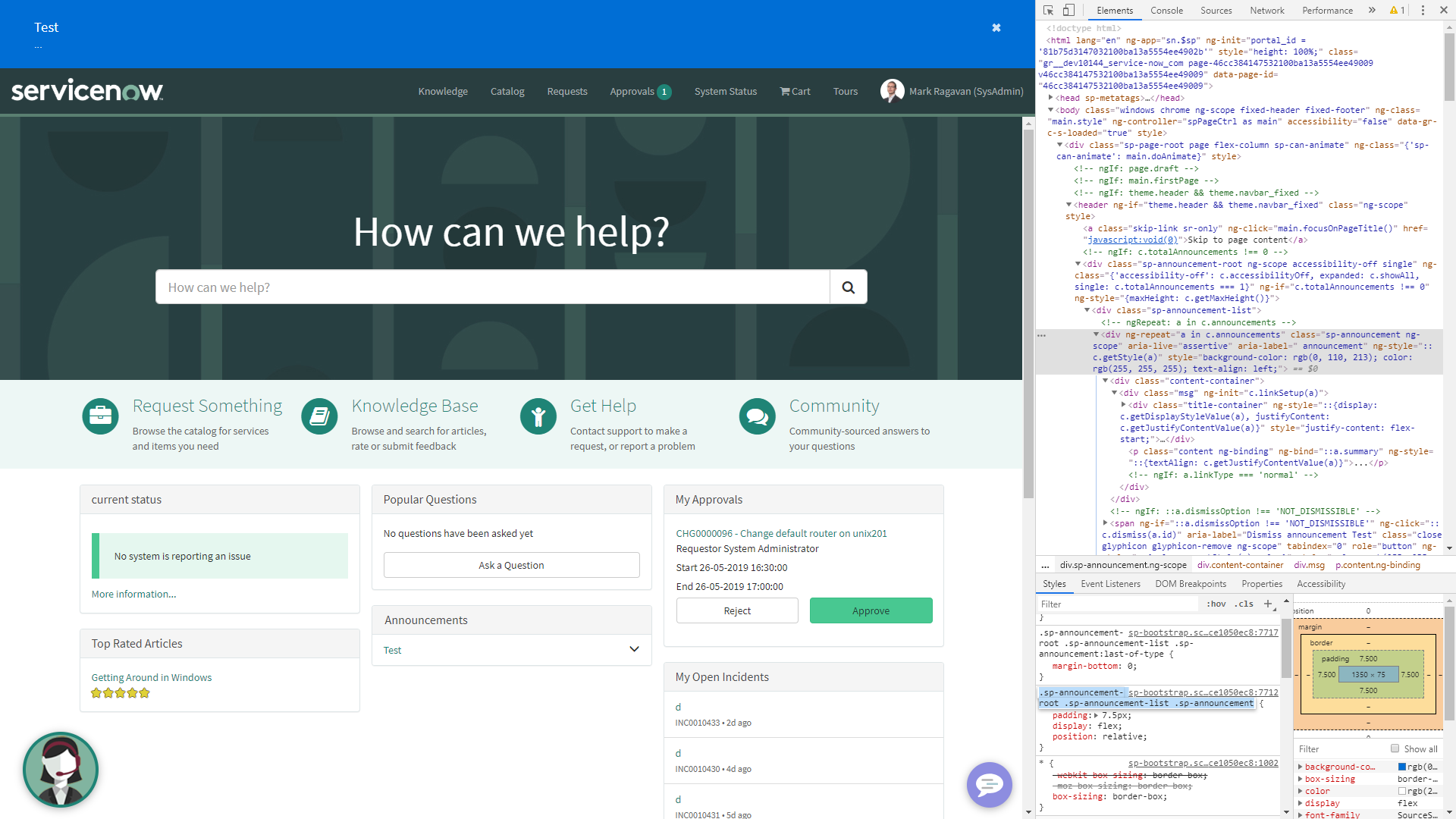

If you right-click -> inspect the announcement element on the page, you can find the various elements/css that create what you see there. From there, you can traverse the element tree to find where the styles are that you want to change. From there, you can add css classes to your portal theme to override the standard css for those announcements.
04-14-2019 09:48 AM
Hi there,
Below some screenshots to help you get started.
Just locate the appropriate CSS elements you want to influence. You can easily overrwite these thru for example the main CSS of the Service Portal.
In this case I wanted to influence the padding. See the code below. Code is tested and oke!
.sp-announcement-root .sp-announcement-list .sp-announcement {
padding: 0px;
Kind regards,
Mark
04-15-2019 12:01 AM
Thanks it helped me at lot!!!
However changing the css of the banner is through portal.
What if i don't want to display the summary at the top of the banner,I have modified the announcement widget not to include the summary but at the banner its still displaying.So what is the component??
Does anyone know about it??
04-15-2019 12:13 AM
I got it.
added the below codes to css
.content
display:none;
Its displaying in the widget but not in the banner.
