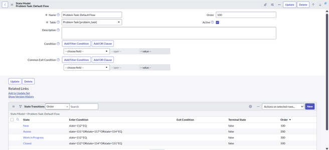

2) I tried to create a new State Model for PTASK for "New" State but it does not change the State to "New", upon Assignment group change.
3) I also created a Business rule that sets back the PTASK State back from "New", "Assess" and "Work In Progress", to "New", upon Assignment group change, but this too, does not work.

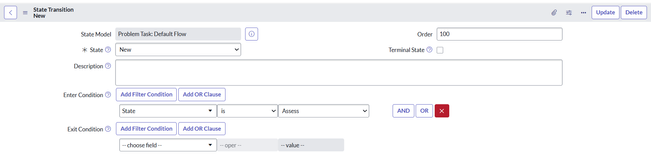

Hi @Ankur Bawiskar ,
It was in Assess state, when the Assignment group was changed.
@AbdurRahmanSnow
Since you are moving from Assess -> New, there is no state model to handle this
Create 1 for New and Enter Condition: State [IS] Assess
Then try
Hi @Ankur Bawiskar
Sorry, it is not working. Please help. I created the "New" State Model.
