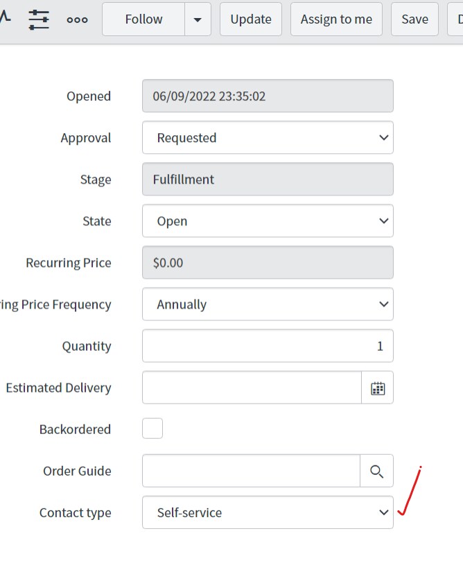

I am working on a scenario to Populate "Contact type" field as "Self-service" on REQ, RITM, SCTASK"
Objective : If a user submits a request from service portal then "contact type" on REQ, RITM, SCTASK so be updated as Self-service.
Note: Contact type is a dropdown field.

Hi Ankur,
If it is for a single catalog I would have gone for Workflow, but there are 250 catalogs.
I am trying to auto populate contact type field with Self-service on "Request table " if that request was submitted from Service portal.
note: "contact type" is a default field which is on "REQ" "RITM" SCTASK".
can you elaborate bit more
Thank you in advance,
Midilesh.N
06-10-2022 01:09 AM
then in before insert business rule of sc_request you will have to determine if the REQ got generated from portal or native view
based on that you can directly set the value for Contact type
