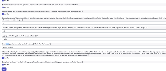

Hi Experts,
This '"Scheduling conflict detected. Review the Conflicts for section" warning message not visible in change form,
i am already checked UI script-ChangeRequestConflictUtils, and UI macro-change_request_conflict_progress. how to resolve this.

Hi @keerthana10
I checked my PDI and it is working
Make sure CI and plan dates are common between 2 changes; only this will work, and you should check that the conflict properties are enabled.
04-03-2025 12:19 AM
I am checked conflict properties are enabled , and i create 2 changes same CI and planned date . the conflict status showing 'Conflict' , but still message not showing.
