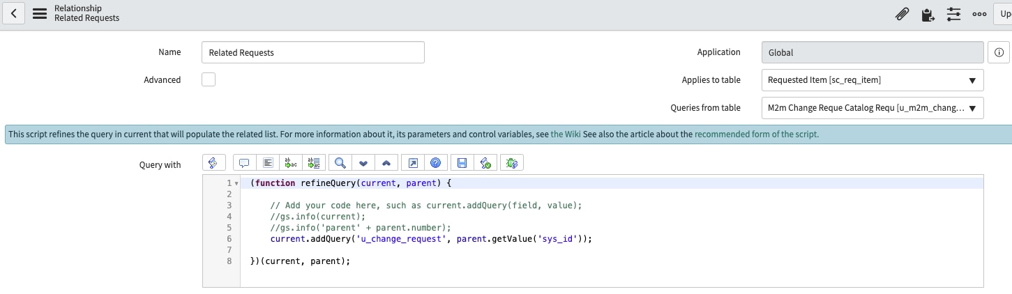

First you need to create a M2M table. Mind looks like this:
Then create the relationship:
Add a "Query with" like this: current.addQuery('u_change_request', parent.getValue('sys_id'));
Then, go to your change record, Configure > Related Lists and add your new list!

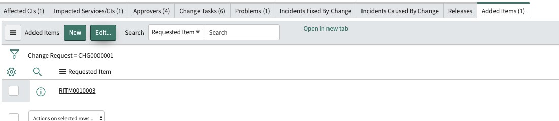

Thanks for the quick response this has worked perfectly. One thing that I can't seem to get working is changing from a new button to an edit button. I have gone into the list control and selected the Enable Edit UI action however this doesn't seem to do anything. Omit edit button is also unchecked!
Any ideas how I can show the edit button rather than the new button on the related list?
Interesting. It doesn't seem to be well documented but...
It looks like you need to add the related list to BOTH tables in order to make the Edit button show up! I added my list to both change_request and sc_req_item and suddenly the edit button appeared. Seems kind of strange to me...but...give it a try.
