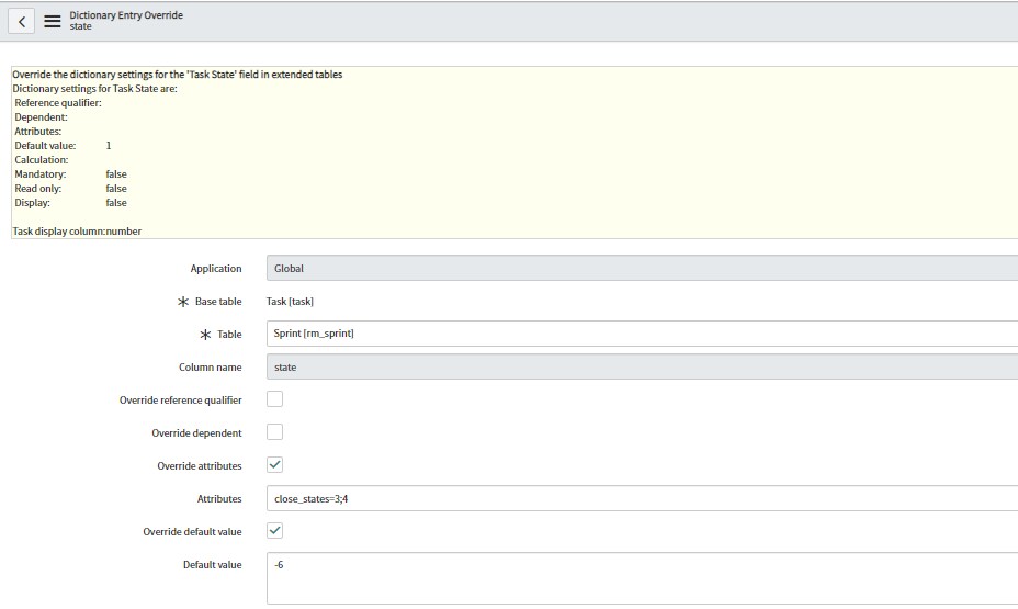

You can check the state value from the field dictionary.
Go to table rm_sprint --> open the 'state' field dictionary and check for the values.
As per the OOB, there is an dictionary override on the state field for rm_sprint table. Please have a look at the below screenshot:

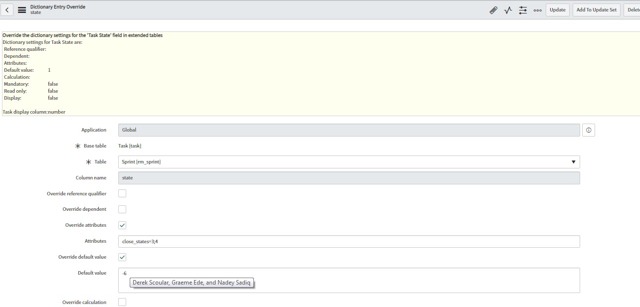

Amend 'state!=3' (filter out the completed sprints) in the reference qual. Please refer the below screenshot.

As per the OOB, complete state value is 3 . So update the reference qual as below to remove the completed sprints from the reference field
javascript:'state!=3^sys_idIN'+ScrumSecurityManager.getStoryDotSprint(current).join(',')
As per the OOB, shows all the sprints
After update, shows only active sprints. Completed sprints aren't showing in the reference lookup:
