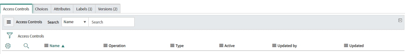

There is a reference field named as 'Asset' in my change form.
When we click on search icon we have below columns.
Right now we can able to search based on column 'Name'.
I want a user can able to search the asset directly by typing in refence field using column 'Name' - name and 'Asset Tag' - asset_tag. When he give name then also it will show the result and if the user give asset tag then also he can able to search.
