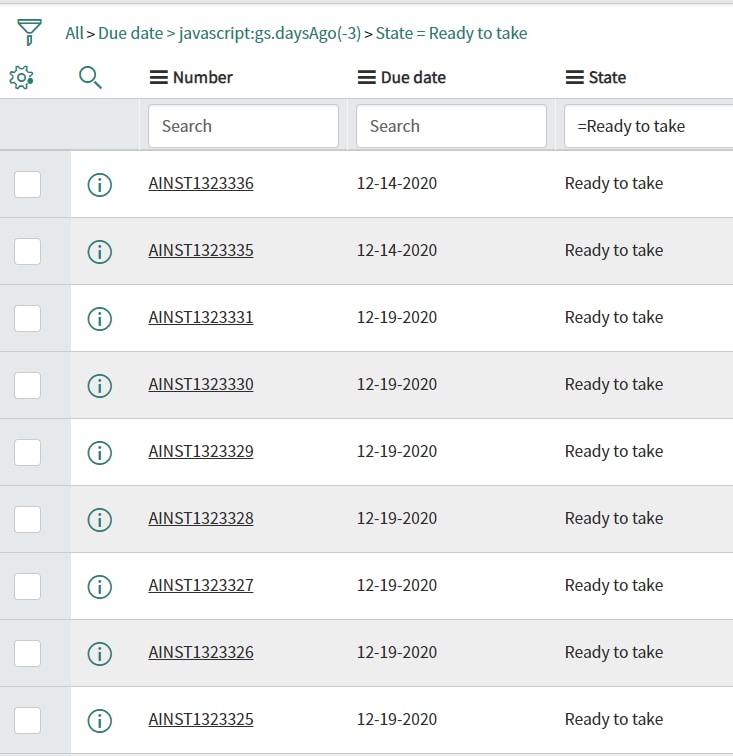

I have already created the Event,Notification email and the Scheduled Job for the Same. But i'm facing the only issue that i'm not able to restrict the count for the particular day.
I have used your encoded query, it looks like below.
I'm not getting the Option on or after and on or before, and it is not giving the expected outcome. Any thoughts on this ?

Query looks fine to me.
Did you find records matching that query in your assessment table
