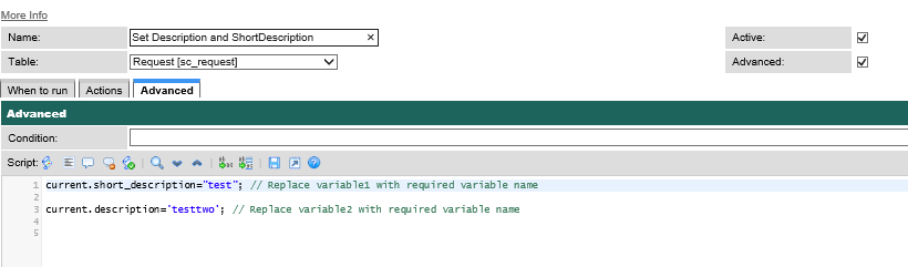

Thank you for the reply, but unfortunately this is one of the many things I have attempted in the Business Rules and the Workflow RunScripts actions.   Why the requested item table?   I tested again twice one under the sc_request and sc_request_item tables and neither worked.
I just tested this
and it populates the information so it appears it has something to do with my variables.   but I know the variables work because I have them populate the task short description and description from the workflow when creating the task.   But know the business rule is setting the test and testtwo values for the request.   What am I missing?
