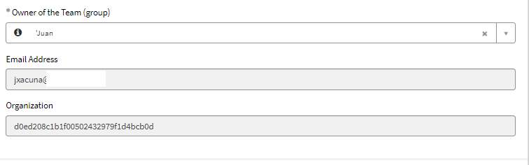

Hi all,
i have a catalog item as follows:
variable 1: Owner of the team (reference to sys_user)
variable 2: email address (single line)
variable 3: organization (singe line)
Variable 2 and 3 should change when variables 1 changes, this works for both only variable 3 is displayed with the sys_id of the organization.
Catalog client script used:
what am i doing wrong here ?
Service Catalog
05-31-2022 03:45 AM
You need to change the Organization variable to be of type Reference instead of Single line text.

05-31-2022 03:49 AM
organization field stays empty on the catalog item
