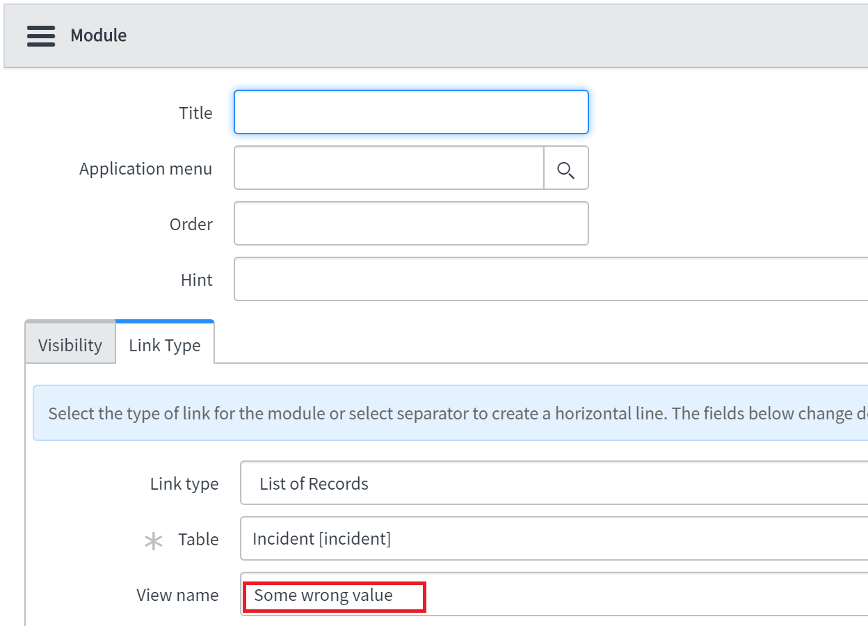

i am facing a strange type of problem . i made an application menu and under it i add three module that is based on three different table. when i am trying to open the module the list or form that are getting displayed are opening in null view. no new button or on opening the list no update or submit is present. any solution is present for that?
and changing the link type in modules is giving no effect . i am changing the link type from List of record     to       new records. but while clicking the module its opening list of record only

Oleg
You can try to verify whether you have some value in "View name" of the Module and make the field empty. See

Kilo Contributor
That worked for me!   Thanks.
Krishna27
Kilo Contributor
worked for me too !!
