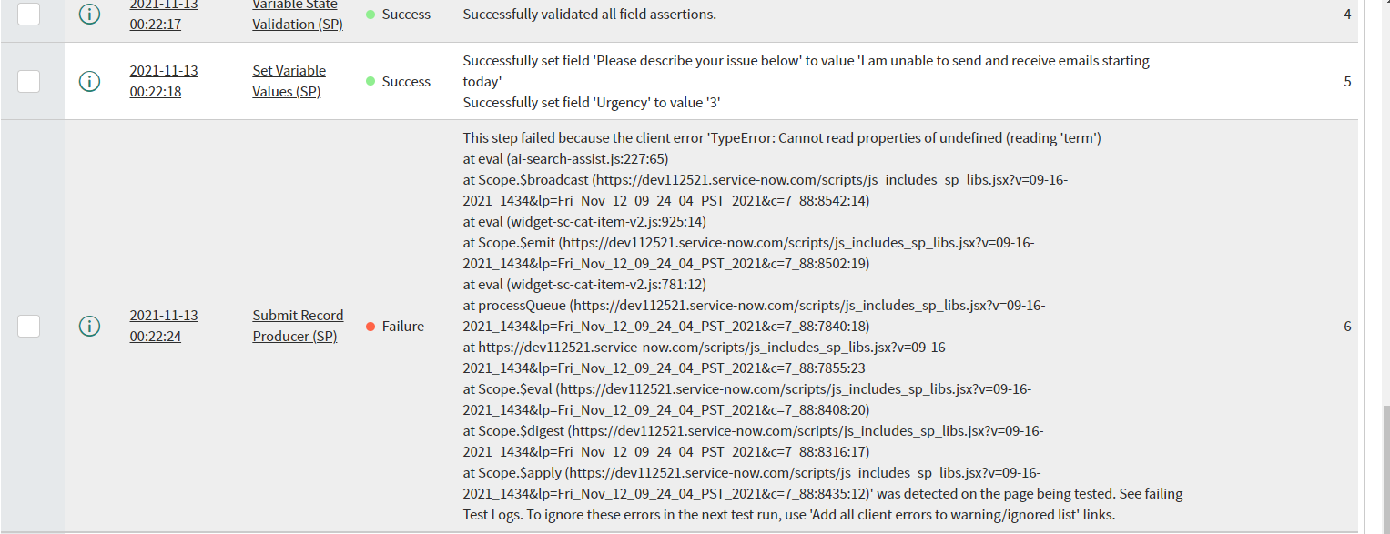

I am facing the error TypeError: Cannot read properties of undefined, never seen it, I don't even know why it is propping up. Kindly help.

Did you check if you get any browser console error when you manually submit the record producer?
you can try to add that error to ignore or warning list and then re run the ATF

Hi , I am getting the similar issue in all the ATF unable to save or submit by ATF script but manually working fine
error as below-
client error 'TypeError: Cannot read properties of null (reading 'promise').
