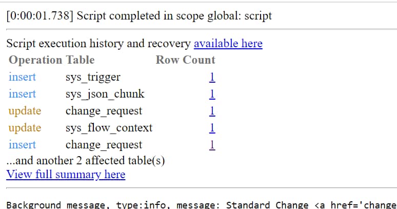

In your First screenshot as well the Change Record got created successfully as shown in red below:

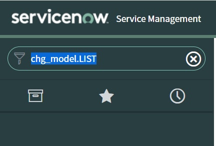

Model value is taken from below Table which is an OOB table and sys id which I have provided should remain same for you as well, but worth double checking it again.
Navigate to the Model table by typing "chg_model.LIST" in Application Navigator menu as shown below:
Now Right click on Standard and copy the sys id which you will need to use it in your script shared above:
