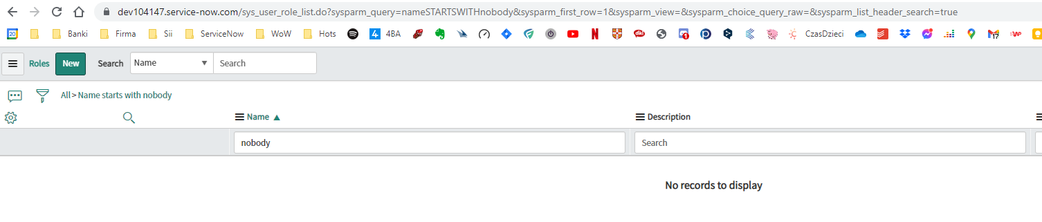

i am unable to see Nobody role in list of roles
where i can see that,

Chanikya,
     The ACL below prevents you from seeing information about the 'maint' or 'nobody' role if the logged in user does not have the 'maint' role.
If you are trying to determine which ACLs have the 'nonbody' role assigned you can navigate to the Application File Table  'sys_security_acl_role.'

From my end, I don't have it at all on my dev instance. Did you find the solution?
